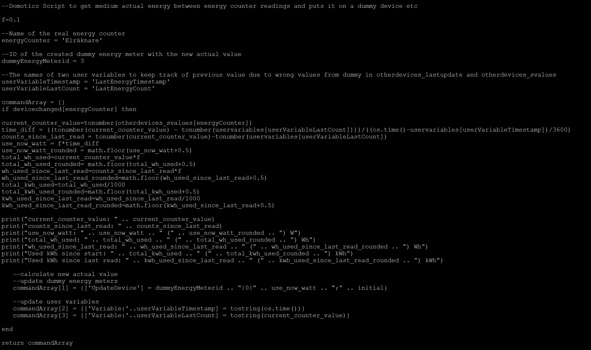

Det spelar ingen roll men detta bör funka med din setup:
Kod: Markera allt
--Domoticz Script to get medium actual energy between energy counter readings and puts it on a dummy device etc
f=0.1
--Name of the real energy counter
energyCounter = 'Elräknare'
--ID of the created dummy energy meter with the new actual value
dummyEnergyMeterid = 3
--The names of two user variables to keep track of previous value due to wrong values from dummy in otherdevices_lastupdate and otherdevices_svalues
userVariableTimestamp = 'LastEnergyTimestamp'
userVariableLastCount = 'LastEnergyCount'
commandArray = {}
if devicechanged[energyCounter] then
current_counter_value=tonumber(otherdevices_svalues[energyCounter])
time_diff = ((tonumber(current_counter_value) - tonumber(uservariables[userVariableLastCount])))/((os.time()-uservariables[userVariableTimestamp])/3600)
counts_since_last_read = tonumber(current_counter_value)-tonumber(uservariables[userVariableLastCount])
use_now_watt = f*time_diff
use_now_watt_rounded = math.floor(use_now_watt+0.5)
total_wh_used=current_counter_value*f
total_wh_used_rounded= math.floor(total_wh_used+0.5)
wh_used_since_last_read=counts_since_last_read*f
wh_used_since_last_read_rounded=math.floor(wh_used_since_last_read+0.5)
total_kwh_used=total_wh_used/1000
total_kwh_used_rounded=math.floor(total_kwh_used+0.5)
kwh_used_since_last_read=wh_used_since_last_read/1000
kwh_used_since_last_read_rounded=math.floor(kwh_used_since_last_read+0.5)
print("current_counter_value: " .. current_counter_value)
print("counts_since_last_read: " .. counts_since_last_read)
print("use_now_watt: " .. use_now_watt .. " (" .. use_now_watt_rounded .. ") W")
print("total_wh_used: " .. total_wh_used .. " (" .. total_wh_used_rounded .. ") Wh")
print("wh_used_since_last_read: " .. wh_used_since_last_read .. " (" .. wh_used_since_last_read_rounded .. ") Wh")
print("Used kWh since start: " .. total_kwh_used .. " (" .. total_kwh_used_rounded .. ") kWh")
print("Used kWh since last read: " .. kwh_used_since_last_read .. " (" .. kwh_used_since_last_read_rounded .. ") kWh")
   --calculate new actual value
   --update dummy energy meters
   commandArray[1] = {['UpdateDevice'] = dummyEnergyMeterid .. "|0|" .. use_now_watt .. ";" .. current_counter_value}
   --update user variables
   commandArray[2] = {['Variable:'..userVariableTimestamp] = tostring(os.time())}
   commandArray[3] = {['Variable:'..userVariableLastCount] = tostring(current_counter_value)}
end
return commandArray
Detta för 10 000 blink per kWh.

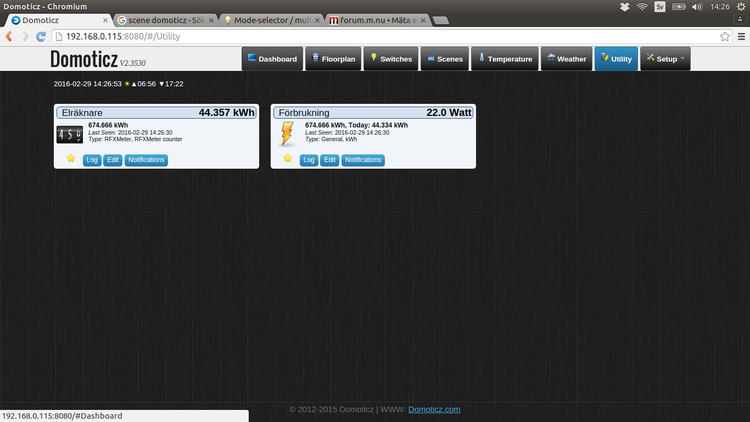

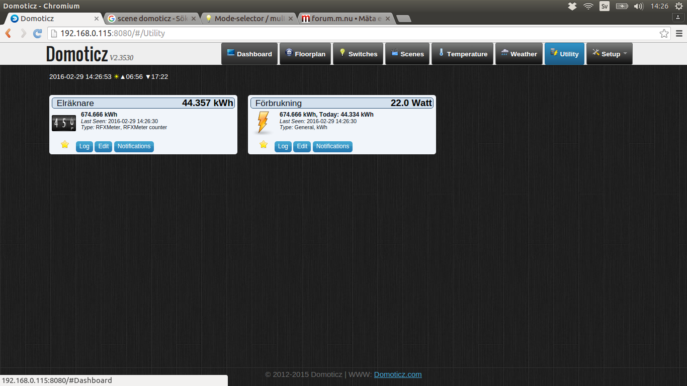

Edit: Elräknare kan du lägga till som RFXMeter Counter så får du en visning av kWh i domoticz samtidigt som du har detta script.

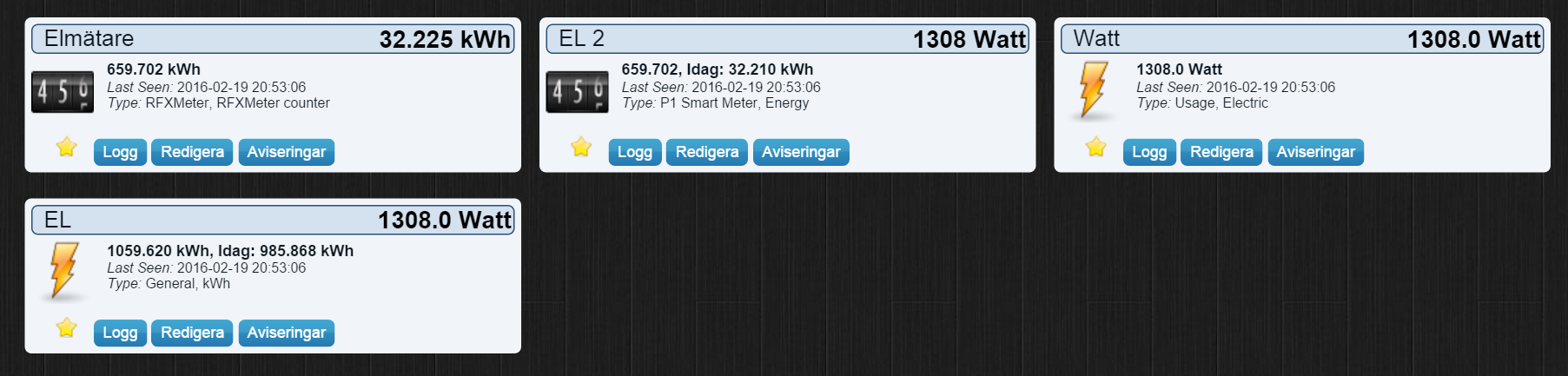

Här är mina men de visar olika värden osv, trots att jag mig veterligen följer domoticz api...
Elmätare och EL 2 är korrekt. Watt stämmer också på samtliga men om jag går in på loggen för EL 2 och tittar på diagrammen så har jag använt 81 000 watt kl 10:20. ;)
Den som heter EL är helt åt skogen som synes. Vissa blir också delade med antalet blink som man anger i inställningarna för Domoticz. Jag har försökt att presentera data till de virtuella sensorerna på alla möjliga sätt utan att få det rätt. Jag har också frågat i Domoticz forum men nu har det gått några dagar utan svar.

Jo jag har en visare för kWh.
Fick det att börja fungera idag. Har bara elmätare än så länge. Så har ingen större koll på nåt av det här, varken Domoticz eller lua.

Jag klistrar in allt via Putty (terminal) och kör UTF-8 i encoding.
Ja, den säger vilken rad felet är på, oftast. Ibland så ligger det längre upp men den stannar på raden som den anger. Den får i alla fall inget värde från din räknare. Nil står för "ingenting".
Kolla så att du verkligen har
Detta skall vara två rader totalt.
Variablarna har du skapat med rätt namn under användarvariabler?

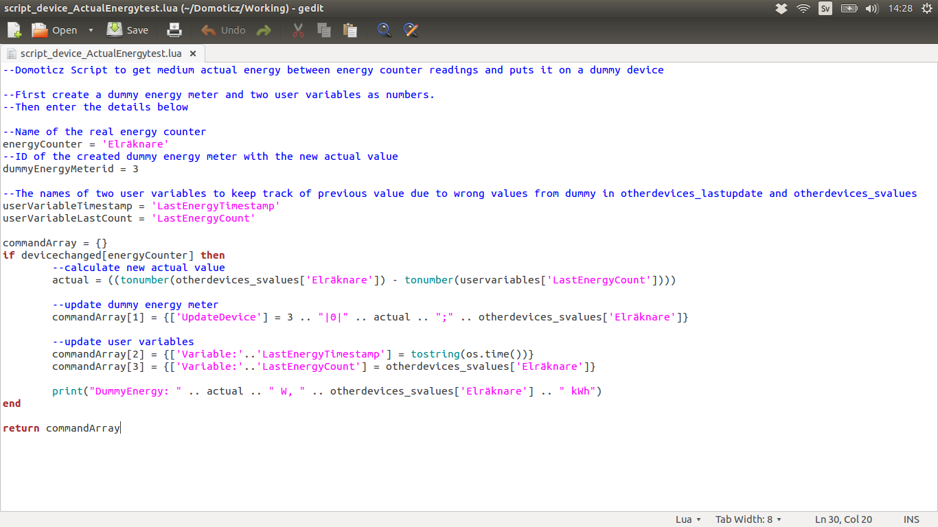

Fick dock i denna raden
actual = ((tonumber(otherdevices_svalues[energyCounter]) - tonumber(uservariables[userVariableLastCount])))/((os.time()-uservariables[userVariableTimestamp])/3600)
Ta bort
/((os.time()-uservariables[userVariableTimestamp])/3600) då jag hela tiden fick error på 'LastEnergyTimestamp'
Varför vet jag inte och vad det gör vet jag inte heller.
Aktuell watt visar dock några decimaler fel.

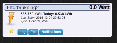

Grymt, det funkade.
Men den visar fortfarande 0Watt i momentan förbrukning. Precis när scriptet kördes så visades ett par Watt, men efter det så har det bara visat 0.
Tack!
