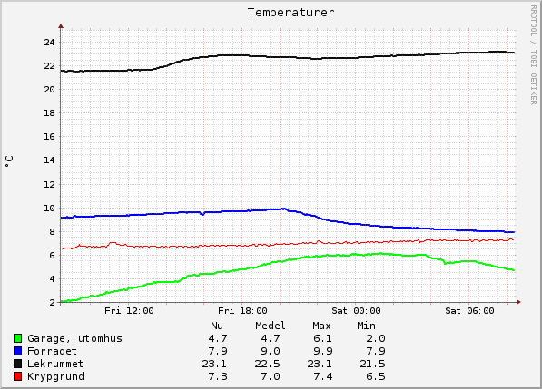

Mitt skript grafar 4 källor och skapar grafer för 24h, 1v, 1m, 1å och 10å. Borde vara hyfsat enkelt att förstå vad du ska ändra, säg till annars så förklarar jag (tips: kolla på mt $path_* my $rrd_* och DEF).
Kod: Markera allt
#!/usr/bin/perl
use RRDs;
my $path_24h     = "/var/www/ha/graphs/temp_day.png";
my $path_week    = "/var/www/ha/graphs/temp_week.png";
my $path_month   = "/var/www/ha/graphs/temp_month.png";
my $path_year    = "/var/www/ha/graphs/temp_year.png";
my $path_10y     = "/var/www/ha/graphs/temp_10y.png";
my $rrd_garage   = "/var/ha/rrddata/garage_outside_temp.rrd";
my $rrd_storage  = "/var/ha/rrddata/garage_inside_temp.rrd";
my $rrd_grund    = "/var/ha/rrddata/basement_temp.rrd";
my $rrd_playroom = "/var/ha/rrddata/playroom_temp.rrd";
my $time_curr   = time();
my $time_day    = $time_curr - 86400;     	# set end time to 24 hours ago
my $time_week   = $time_curr - 604800;    	# 1 week ago
my $time_month  = $time_curr - 2419200;   	# 1 month ago
my $time_year   = $time_curr - 29030400;  	# 1 year ago
my $time_10y    = $time_curr - 290304000;	# 10 years ago
generate_graph ($path_24h,   $time_curr, $time_day);
generate_graph ($path_week,  $time_curr, $time_week);
generate_graph ($path_month, $time_curr, $time_month);
generate_graph ($path_year,  $time_curr, $time_year);
generate_graph ($path_10y,   $time_curr, $time_10y);
sub generate_graph
	my $path       = shift;		# Path to the generated graph
	my $time_end   = shift;		# End time
	my $time_start = shift;		# Start time
	RRDs::graph "$path",
			"--start= $time_start",
			"--end= $time_end",
			"--title= Temperaturer",
			"--height= 300",
			"--width= 500",
			"--vertical-label= °C",
			"-E",
	      "DEF:Garage=$rrd_garage:garage_outside_temp:AVERAGE",
			"COMMENT:\t\t\t\t\tNu     Medel    Max    Min\\n",
			"HRULE:0#00FF00",
	      "LINE2:Garage#00FF00:Garage, utomhus\t\t",
			"GPRINT:Garage:LAST:%6.1lf",
			"GPRINT:Garage:AVERAGE:%6.1lf",
			"GPRINT:Garage:MAX:%6.1lf",
			"GPRINT:Garage:MIN:%6.1lf\\n",
	      "DEF:Storage=$rrd_storage:garage_inside_temp:AVERAGE",
			"HRULE:0#0000FF",
	      "LINE2:Storage#0000FF:Forradet\t\t\t",
			"GPRINT:Storage:LAST:%6.1lf",
			"GPRINT:Storage:AVERAGE:%6.1lf",
			"GPRINT:Storage:MAX:%6.1lf",
			"GPRINT:Storage:MIN:%6.1lf\\n",
	      "DEF:Playroom=$rrd_playroom:playroom_temp:AVERAGE",
			"HRULE:0#0F0F0F",
	      "LINE2:Playroom#0F0F0F:Lekrummet\t\t\t",
			"GPRINT:Playroom:LAST:%6.1lf",
			"GPRINT:Playroom:AVERAGE:%6.1lf",
			"GPRINT:Playroom:MAX:%6.1lf",
			"GPRINT:Playroom:MIN:%6.1lf\\n",
	      "DEF:BasementTemp=$rrd_grund:basement_temp:AVERAGE",
			"HRULE:0#FF0000",
	      "LINE1:BasementTemp#FF0000:Krypgrund\t\t\t",
			"GPRINT:BasementTemp:LAST:%6.1lf",
			"GPRINT:BasementTemp:AVERAGE:%6.1lf",
			"GPRINT:BasementTemp:MAX:%6.1lf",
			"GPRINT:BasementTemp:MIN:%6.1lf\\n";
	my $err=RRDs::error;
	if ($err) {print "problem generating the graph: $err\n";}
Reultatet blir en sån här graf:
