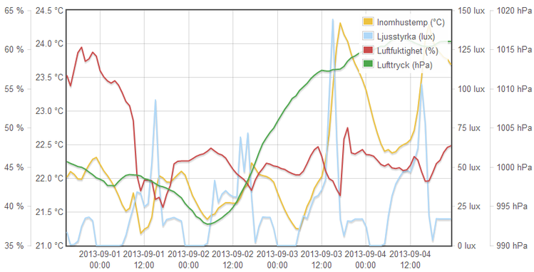

Här är HTML/PHP/Java koden som ritar flot diagrammet:
(för tillfället lever sidan i Ajax-exempelkatalogen som följer med flot distributionen, t.ex. har jag inte ändrat något i ../examples.css)
Kod: Markera allt
<!DOCTYPE html PUBLIC "-//W3C//DTD HTML 4.01//EN" "http://www.w3.org/TR/html4/strict.dtd">
<html>
<head>
<meta http-equiv="Content-Type" content="text/html; charset=utf-8">
<title>Signaler från EDS0068</title>
<link href="../examples.css" rel="stylesheet" type="text/css">
<!--[if lte IE 8]><script language="javascript" type="text/javascript" src="../../excanvas.min.js"></script><![endif]-->
<script language="javascript" type="text/javascript" src="../../jquery.js"></script>
<script language="javascript" type="text/javascript" src="../../jquery.flot.js"></script>
<script language="javascript" type="text/javascript" src="../../jquery.flot.time.js"></script>
<script type="text/javascript">
$(function() {
function degreeFormatter(v, axis) { return v.toFixed(axis.tickDecimals) +" °C"; }
function percentFormatter(v, axis) { return v.toFixed(axis.tickDecimals) +" %"; }
function hPaFormatter(v, axis) { return v.toFixed(axis.tickDecimals) +" hPa"; }
function luxFormatter(v, axis) { return v.toFixed(axis.tickDecimals) +" lux"; }
var options = {
lines: { show: true },
xaxis: { mode: "time",
timeformat: "%a-%d %H:%M" },
yaxes: [ { tickFormatter: degreeFormatter },
{ tickFormatter: percentFormatter },
{ tickFormatter: hPaFormatter, position: "right" },
{ tickFormatter: luxFormatter, position: "right" } ] };
var data = [];
function onDataReceived(series) {
data.push(series);
$.plot("#placeholder", data, options);
$.ajax({url: "rumstemp.php", type: "GET", dataType: "json", success: onDataReceived });
$.ajax({url: "luftfuktighet.php", type: "GET", dataType: "json", success: onDataReceived });
$.ajax({url: "ljusstyrka.php", type: "GET", dataType: "json", success: onDataReceived });
$.ajax({url: "lufttryck.php", type: "GET", dataType: "json", success: onDataReceived });
</script>
</head>
<body>
<div class="demo-container">
<div id="placeholder" class="demo-placeholder"></div>
</div>
</body>
</html>
I samma katalog har jag grovt yxat till 4 ytterst rudimentära PDP skript som läser upp en kurva och JSON-kodar den o dumpar den rätt ut "i Ajax-etern". Observera att jag först o sist lägger ut etikett, färg o axelnummer med lite råa "echo" anrop. Detta kan säkerligen göras på ett bättre sätt - men som sagt, detta är ihophackat under några kvällar efter att ungarna o sambon gått o lagt sig o man får lite "kvalitetstid" för sig själv...
Här är koden till
rumstemp.php, dom andra tre är väldigt lika - i pricip skiljer sensorid o property samt label/axel/färg.
Kod: Markera allt
<?php
$db = mysql_connect("localhost", "user", "password");
mysql_select_db("onewire",$db);
$query = "SELECT UNIX_TIMESTAMP(time)*1000 \"time\", value from data where sensorid=1 and property=1 and aggregate=2 order by time";
$result = @mysql_query ($query);
$arr = array();
while($row = mysql_fetch_object($result))
$arr[] = array($row->time*1,$row->value*1);
echo "{\n\"label\": \"Inomhustemp (°C)\",";

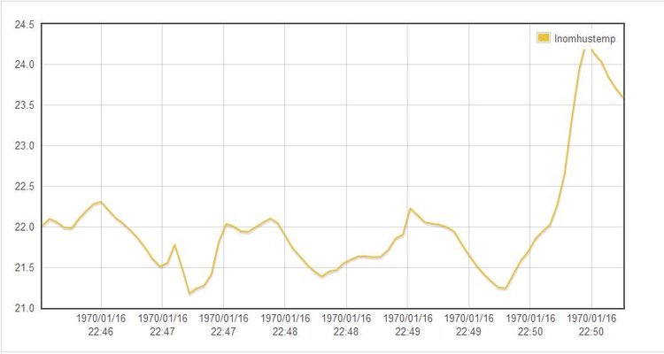

Observera att aggregate 2 motsvarar timmedelvärde (dygnsmedel, min o max följer med 3, 4 o 5).
Initiala test indikerar att prestandan blir lidande med minutdata i en veckotrend - därför har jag valt timvärden i detta exempel.
Fick jag med allt?
